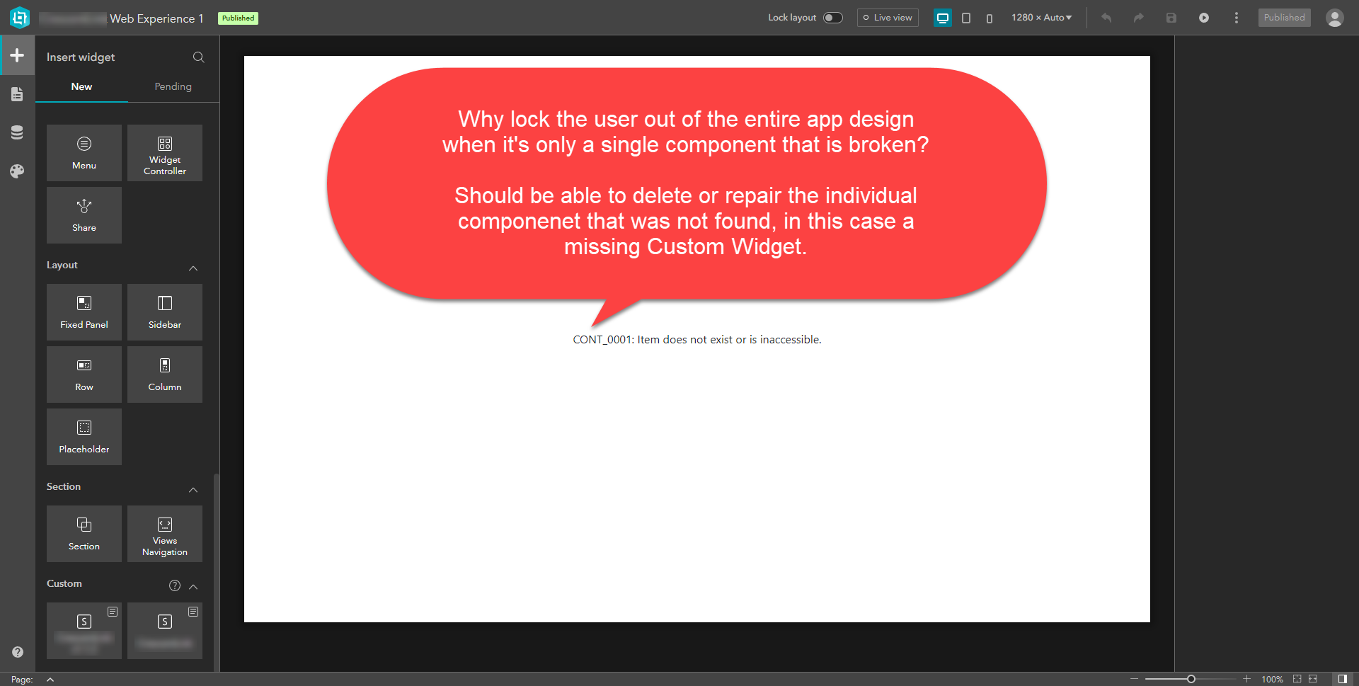

ArcGIS Enterprise 11 now allows for custom widgets to be used directly in ArcGIS Portal's Experience Builder.  In testing this, we discovered that if an Experience Builder app is built using a custom widget, and then later that custom widget is deleted from the Portal's content, the Experience builder app will be rendered useless and need to be deleted and recreated from scratch.
I understand how something that was deleted could no longer be accessed, but why cause then entire app to no longer function rather than having the ability to "remove" or "repair" the individual item (in this case a missing custom widget)?
Instead, we get the full screen error message below:
CONT_0001: Item does not exist or is inaccessible.

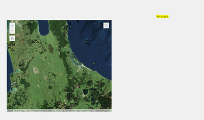

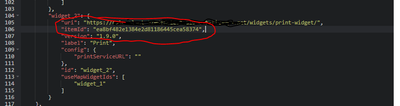

Hi Tim,
The issue is caused by the itemId in the configuration of the Experience. If you use something like ago assistant to view the JSON configuration, then you can modify the configuration and remove the itemId of the widget. This will then allow the experience to load and just give a Fail to load message where the widget used to be. This way at least you can get in and tidy up the widget, with out having to recreate the experience.

with ago Assistant, I took the new ItemId of the widget and replace the old ItemId with the new one in the json file of my broken experience.

Thank you all for bringing this to our attention. Deleting custom widget items should not cause apps stop working. This is a known bug, and we plan to address it in ArcGIS Enterprise 12.0. In the meantime,  the workaround is to:
  • Re-upload the custom widgets to ArcGIS Enterprise.
  • Use ArcGIS Assistant to open the app’s JSON configuration file.
  • Update the custom widget item IDs to the new ones,  as described in the @Grant-S-Carroll 's post.
