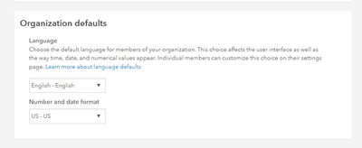

Time formatting is controlled in the Organization Defaults of your Online/Enterprise environment.

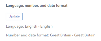

CS_IBM
Hi Jeffrey<
Thanks for your post.
I checked and my Number and date format is UK, not USA??
My Edge browser Language settings are also set as English (United Kingdom).

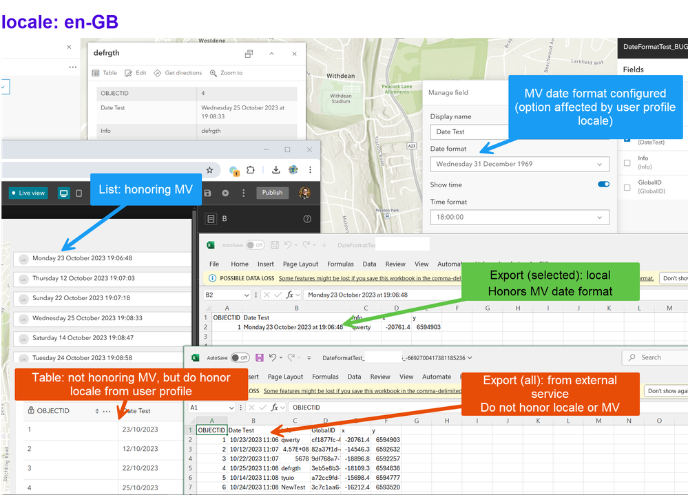

TonghuiMing
Hi @CS_IBM
It looks good when I change my profile setting (not the org setting) to en-GB:
Could you please help confirm if this problem still occurs on your app? Also, which widget you saw the problem with will help us identify the reason.

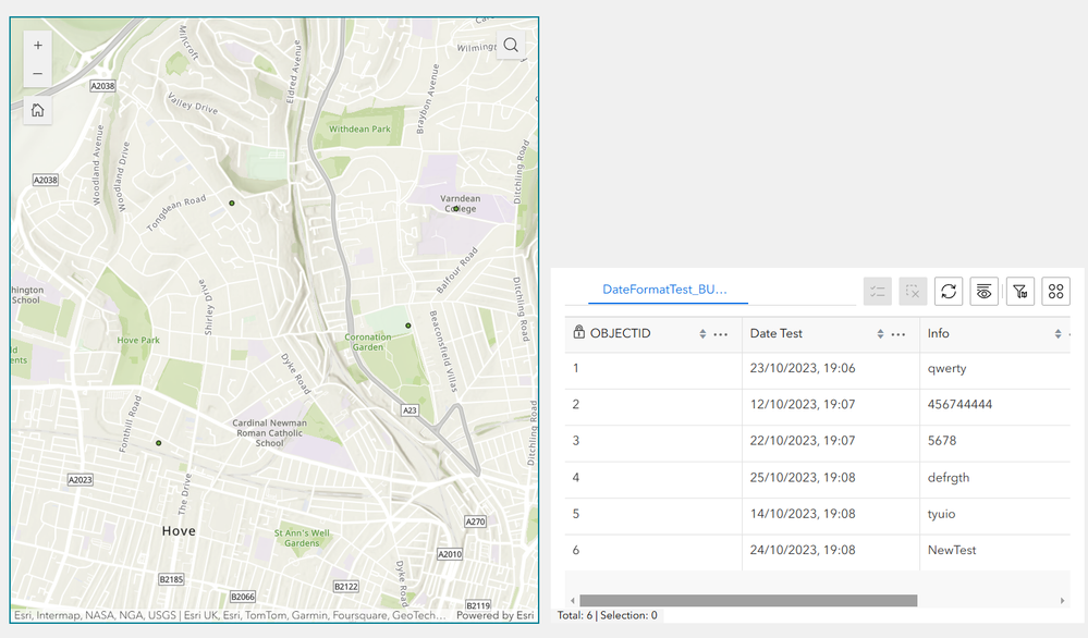

SerjStol
I have similar issue. Web Map set to UK timezone, AGOL Organization settings set to UK timezone and date format. Experience Builder also set to London timezone.
When we export data using Table Widget into CSV, all the dates are in US mm/dd/yyyy format!
TonghuiMing
Hi @SerjStol,
It is a bit complicated in your case -
1. You're using the Table widget. In case you did not notice, the date format displayed in the table widget is now different from other widgets which honor the format from MV's setting and user profile locale, and is to be supported by the according party
2. The Export action itself is separate from any widget and it has different behaviors - if selected, it is done locally so the format is good; however, export all sometimes utilizes an external service, and it seems like they do not honor any settings yet - which I believe it's your case.
