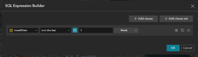

Have you tried the expression builder in the filter widget?
It has a last week option:
R_
JonathanMcDougall
Hi, thanks for the reply.
I should have perhaps been more specific - the last 1 week counts back 7 days from today and I'm also looking to have this filter used to create dynamic text.
eg; Number of objects created last week; 999 (filter being "Date is Last Week", a change of xxx.
So, last week one or even last 7 days moves forward with every new calendar day. A "is Last Week" option would "cement" the return to a set period.
