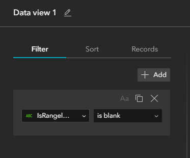

When I add a data view to the List widget it changes from listing the field value to simply saying the name of the field.  The view filter is just a simply if blank.  Is this a bug or am I doing something wrong?  It also does not seem to actually filter anything.

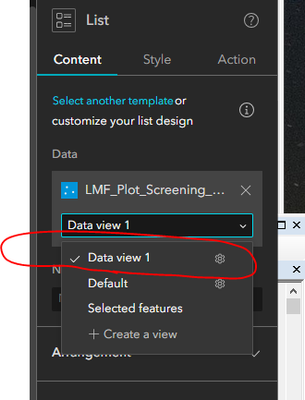

I think what you are trying to do should work, but you will need to point the content of your List Widget to Data View 1.

Well setting it to Default on Text somehow got my POINT_ID to show again.  Seems to be a bug in here somewhere.

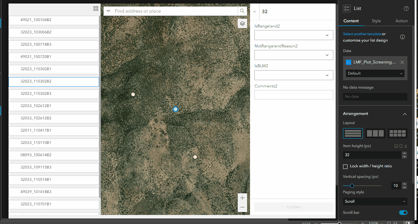

But the List widget is still not updating until I refresh the browser.  Is there a way to get it to remove the records from the list widget as soon as I make the edit in the Edit widget?  I would think it should disappear from the List the second I hit Update right?

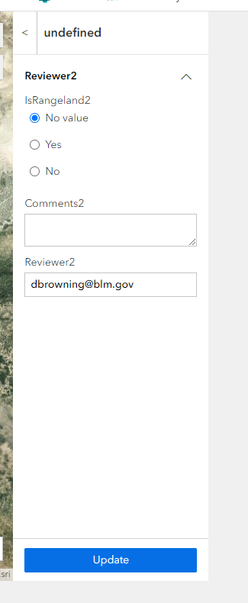

Only thing left is trying to figure out where I set this undefined title in the Edit widget.  Tried changing everything I could find in ExB and the webmap.
Strangely it shows a value when in the builder editing the project.  Seems common for the editor and published to be different.
