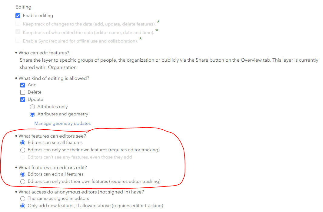

Data Centric Editor widget in my Experience Builder page only allows editors to edit records they created.  The "Update" button is active, but edits are not applied unless a user had created that record.  Here's the Editing settings on the feature service view. Please notice that Editors can see all features, which is working, and Editor can edit all features, which is NOT working.  All features can be edited outside of Experience Builder (Map Viewer Classic, ArcGIS Pro).
