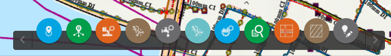

The client has a specific color requirement for widgets inside which are provided within the widget controller.
Widget SVG Icon:  Is there a possibility to change the color of individual widgets inside the widget controller.
This is what was obtained from experience builder as you can see all widgets have same color.
But I want the icons to be as below.
This was achieved using web app builder.
Thanks.
