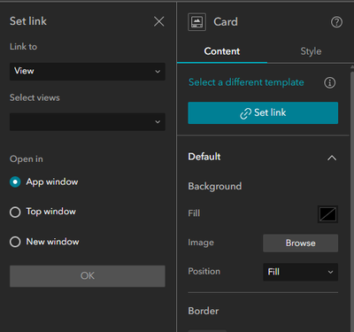

Thanks for the suggestion! Where do I set the action once I've styled the card (I would like the map to switch from a map of roads to a map of sidewalks)? I don't see the option in the usual spot - a pane on the right side of the screen.
JeffreyThompson2
MVP Frequent Contributor
Cards do not have access to the Action options. Your question said you wanted to change Views which can be done through the Set Link options.

Thanks! I couldn't figure out where the Set Link button was but I've got it now and my app is working how I want it to now.
