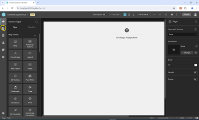

I have a couple of thoughts on what you might be seeing.
First, when you are in the editor application for Exb, you can add data sources from the left:
This may only make it available to plug into from out of the box widgets though.
You may need to explore creating a settings section that allows you to select the layer it should be linked to, and then you can use similar code to access it based on the index it was added to useDataSources.
(I don't know how experienced at other Dev work you may be so I'll add some definitions:
  An index is basically a natural number (0 to n) that represents position in the useDataSources Array
  You can create an enumeration type that has a key on the left that you can know internally is to reference a particular DataSource, and a integer on the left.  this article has some examples of different enums, but the values probably can be simply 0, 1, 2, 3, 4... 100 depending on how many data sources you need to add in settings for the widget.
EXB Widget settings are configured when you drag or add a widget to the application canvas, and are saved when you click save. (note if you change the order of settings, or remove one in the middle, you may have to read all the ones in sequence to the end of the settings file depending on how you code it.  So something to keep in mind.)
Once its in settings you only need to create a DataSourceComponent somewhere in the widget, that binds to that use Data source. something like this:
<DataSourceComponent widgetId={props.id} query={{ where: '1=1' }} useDataSource={props.useDataSources[0]}>{renderData}</DataSourceComponent>
Note if you want the user to be able to update the query's where clause that you'll have to get that data from controls on the widget, and update it in state to pass to this query to do the filtering.
Hopefully, that's enough to get you started.
