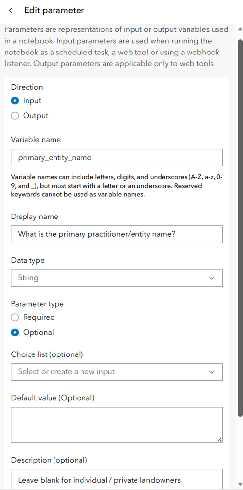

Thank you - I will do more testing! I used variablename as a stand-in for all the different variable names of the parameters that are in the Notebook. For example, one of the input parameters has a variable name of primary_entity_name:
The input parameters were inserted into the Notebook as variables.
