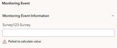

The image below is from the EB Editor Widget. I would like the user to be able to click on "Add record" to enter a new Monitor Event and when they do this have the path or link to the correct Survey123 survey show up...it is currently failing to calculate.  This is my calculated expression in the smart form for my Surey123 Survey Field:
var baseUrl = "arcgis-survey123://?";
var params = {
  itemID: "0b4c2dd917084d14bf5c82df41d6abec",
  "field:Site_GUID": $feature["GlobalID"],
  "field:OrganizationGroup_MonEvent": $feature["OrganizationGroup"],
  "field:MonitorSiteName_Event": $feature["SITENAME"]
return baseUrl + UrlEncode(params);
This is what appears in the editor widget after clicking Add Record:
Thank you in advance for your assistance!!!
