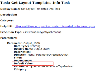

Hi, the print widget calculates the printing extent based on the "webMapFrameSize" stored in the Get Layout Templates Info Task.
Please check if you have "Get Layout Template Information Task" in your print service.

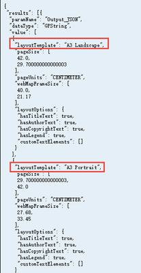

Another place to check is to open the Get Layout Templates Info Task - Execute Task - Execute Task (GET), to see if the list of values contains all custom layouts::

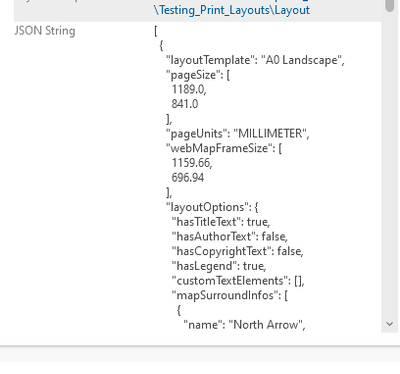

Hi @ShengdiZhang  , thanks for your response . i have added the get layout info task .from the arcgis pro and in arcgis pro it is showing all the values .
But in the rest sevice . what parameters should i pass to check and get the result i am confuswed in json
IT is showing this .

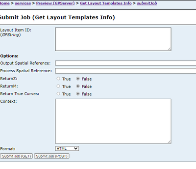

Hi, if you want to test the Get Layout Templates Info task, you can simply click the Submit Job (GET).

Hi, usually the Layout Item ID should be empty as this will set a default value for the layout task. If the default value is not set, passing in an empty layout item ID will return information for all layouts. However, if the default value is set, passing in an empty Layout Item ID will only return information for that layout.
Can you try setting the Layout Item ID to null in both tasks and then publishing the service again to see if that fixes the bug?
