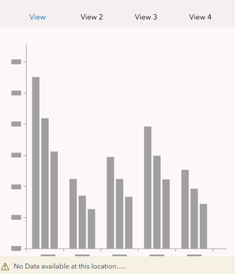

Wei_Ying
Hi @ElieRizk this issue has been fixed on AGOL June release.
ElieRizk
Thank you. I checked it, and it partially solves the issue.
The message placement is not visually prominent for users; consider repositioning or highlighting it to improve visibility. It would be more effective if displayed near or directly above the grey bar charts to draw attention to the context of the missing data

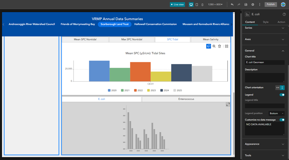

RSchaffner
The customized "no data" message is not working in my project. In the screenshot below, there is no data in the filter for the E. coli chart, but the customized "No Data Available" message does not appear anywhere. Any suggestions?No_Data.png
ElieRizk
@RSchaffner  As mentioned by @Wei_Ying , the update was implemented in the AGOL EXB June release (it is shown as per my screenshot), not in the Developer Edition. Unless I missed something, this means the availability depends on which version you are currently using.
