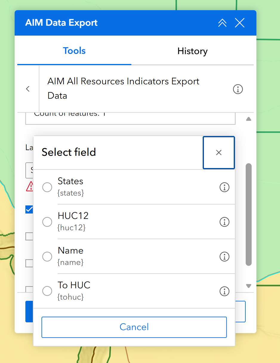

If you go from a popup then Set As Analysis input to a tool that uses a field list off that layer works fine.

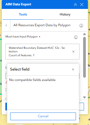

But if you use the Select widget, select a polygon, then do Set as Analysis input from there, then the field list will not populate at all.
@Wei_Ying I think this is similar to the Search widget issue with the first popup.  The tool is getting an input of just # somehow.
We also see that if you have a popup from the last session up and come back later then try Set As Analysis input that will fail also saying the input layer is #.  The user must reclick the polygon, get a new popup, then its happy.
I am happy to show the team all these quirks if it will help (I have 10 now I think).   This is a AGOL ExB.

Update to show here is what we see in the server logs.  It gets # as the layer input in these cases.
line 1228, in ListFields return gp.listFields(dataset, wild_card, field_type) , line 378, in listFields self._gp.ListFields(*gp_fixargs(args, True)))   OSError: "#" does not exist
Hope that helps find it.
