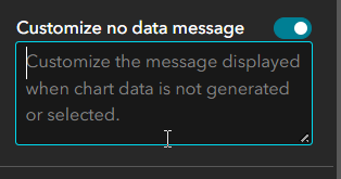

We have been waiting for ESRI to solve this issue for a long time. Still, unfortunately, in EXB developer edition 1.17, ESRI mentioned that this issue has been solved: "You can enter a message to display when no data is selected or the chart is otherwise not displaying data." We tried to fill it out as requested, but unfortunately, this is not working.
Kindly advise, are there any additional steps to take after filling in the custom message?

@Wei_Ying thank you for your support.
I am expecting the no data message to change to the following message when no data is available.
Unless you are indicating another place that will be affected by this message, "The no data message can be customized, and it displays in a warning bar". Can you elaborate or share a sample where it should be displayed?

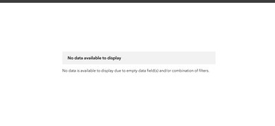

I am using the exb developer edition. I tried this option unfortunately the message didn't appear in the chart. The default message is still appearing there as shown in the provided screenshot.
I am afraid if there's a bug in this tool and it is not distinguished.
