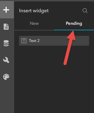

ShengdiZhang
Hi, you can reuse widgets by adding them from the Pending tab in the Insert widget panel.
Doc can be found at: https://doc.arcgis.com/en/experience-builder/latest/build-apps/design-for-mobile-devices.htm
JamesMadden1
I can reuse the widgets by adding them into the pending tab but the widgets get destroyed and recreated whenever the layout changes.  This is not ideal since users may toggle something on and then resize the window but the widget will show the layer as being off.  I imagine there must be a way to maintain the widget state between layouts.
