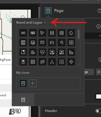

In Experience Builder, how do I set a custom icon to an existing widget icon.  I have some Section Views that have widgets within it and I want the View icon to be the widget icon.  However the icons are super limited in the custom widgets.  In Developer, I found the icon SVG file for the widgets icons I want to use within the folder structure, but when I select custom icon,  it only gives me the option for png, jpg, gif.  Anyway,  I can import those existing widget icons into this window so I can select them without having to reinvent icons?  Using Developer 1.16.

In case you missed it, there is a dropdown menu at the top of that window with a lot more icon choices. All of the default widget icons should be in there somewhere.
But if that doesn't work and you have an svg, here's a file converter.

Thanks @JeffreyThompson2.  I'm new to Experience Builder and I completely missed that being a drop down.  So many options now.
