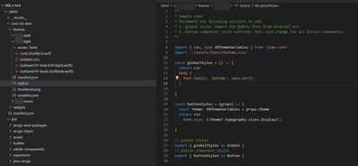

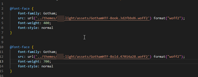

It's a year later so maybe this was fixed. The way I got this to work with a local woff was by including a reference to the css in my style.ts and using absolute paths in my font.scss file. I tried using relative paths but it just didn't work. The global style body isn't necessary (you should do this through variables.jons I think) I just put it there to ensure that code was working
DavidWilton
Actually, this didn't work once I'd deployed the app. I ended up doing it in the style.ts like this
const globalStyles = () => {
  return css`
  body {
    font-family: 'Gotham', sans-serif;
    --pop-blue-light: #00AECB;
    --pop-yellow: #FFC726;
    --pop-orange: #F07B05;
    --pop-magenta: #E50E56;
    --pop-purple: #645FAA;
    --pop-green: #008850;
    --pop-blue-mid: #277BB4;
  @font-face {
    font-family: "Gotham";
    src: url("${urlUtils.getFixedRootPath()}themes/my-light/assets/fonts/GothamHTF-Book.woff2") format("woff2"),
      url("${urlUtils.getFixedRootPath()}themes/my-light/assets/fonts/GothamHTF-Book.woff") format("woff");
    font-weight: normal;
    font-style: normal;
  @font-face {
    src: url("${urlUtils.getFixedRootPath()}themes/my-light/assets/fonts/GothamHTF-Bold.woff2") format("woff2"),
      url("${urlUtils.getFixedRootPath()}themes/my-light/assets/fonts/GothamHTF-Bold.woff") format("woff");
    font-weight: bold;
    font-style: normal;
// global styles
export { globalStyles as Global }
