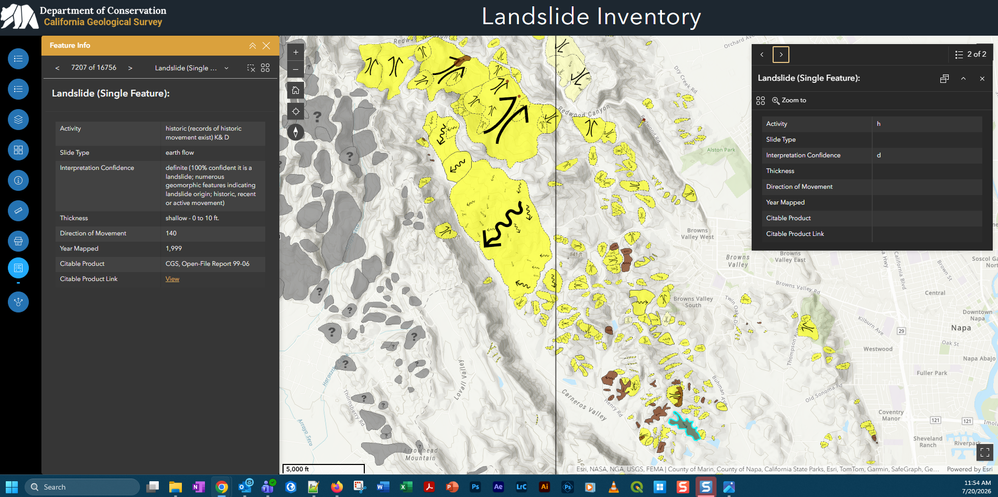

Experience Builder bug? Arcade expression selects 8 fields, creates new aliases, and places them in the order I want. Works perfectly in Map Viewer. However, if I click on a feature in Experience Builder, the pop-up is nearly empty except for the field name aliases.
Just for a test, I inserted the "Feature Info" widget and it displays all the information perfectly while at the same time the pop-up does not. Please see screenshot.
Thanks for any info!
