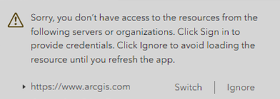

Hi, Thanks so much @AlixVezina for your reply and suggestion.  I did have a go with that but not too keen on the access error that comes up for my users when there isn't technically an error, it's just they don't have access to all the layers.  Is there a way around this?
My "group 1" editor user would get this error as they can't see the group2 editable view layer for example.  They can click ignore but all my users will be getting this error as they won't be able to see all the layers in the web app.  The error keeps coming up with every refresh so difficult to make a polished product with this method.  Any ideas?  Thanks heaps.  It is greatly appreciated!
