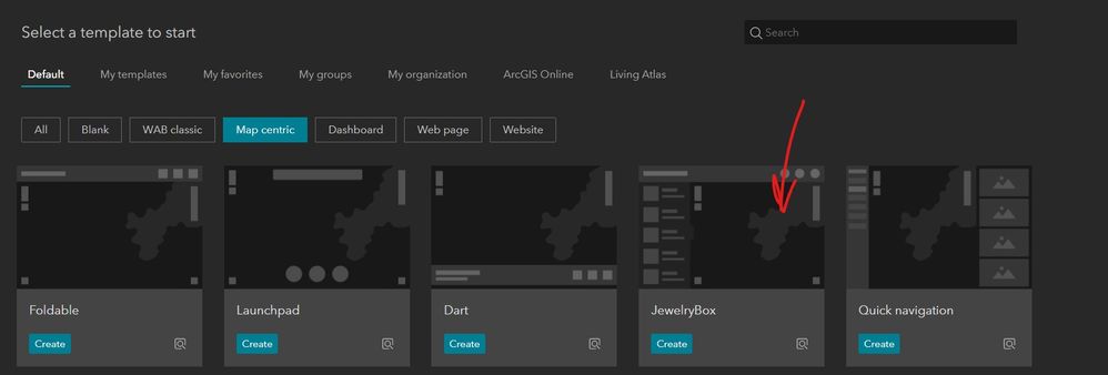

Hello Helen,
I would recommend to get started with the JewelryBox template and tweak the configuration/settings to your liking with 2D/3D maps.
A sample app based on this template can be found here: Current Development Projects (arcgis.com)
