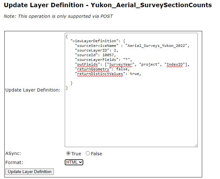

Hi @anbinh ,
I am trying to update the layer definition for a view layer I created from a hosted AGOL feature layer as a work around fro the lack of a Groupby option in Experience Builder.
I have the following information included and it seems successful in theory but the view layer data table still shows all of the records. I have tried to just query the REST endpoint and I see the info correctly summarized there. The view layer is a point layer and really I just want the nonspatial (no geometry) returned so I can use this as a datasource in an EB list widget. Is this possible or do you see an reason the below isn't working? I very seldom use this workflow.
When I click to Update Definition the below processes as complete or updated, but all the records are still in the Data table of the hosted feature layer as they were originally.
Thanks in advance,
Kathy

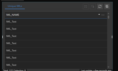

JohnEvans6
Hi,
Any thoughts on what I may be doing wrong/missing? This seemed like it would solve my exact problem (I wanted to show users a table of unique values from a FeatureSet). I took the complete feature set, filtered down to the unique values (2 of 122), and it all looked good:
But when I plugged my Arcade data script into a table, I got all records instead of my filtered set:

JohnEvans6
Happy to thanks for looking. Should be pretty straightforward:
var fieldName = "IWL_NAME";
var features = FeatureSetByPortalItem(Portal("https://faasysops.maps.arcgis.com/"), '8abc49df0f9247b9abd7b62eaa37952d', 0)
var uniqueIds = GroupBy(features, [fieldName], { name: "f_objID", expression: "OBJECTID", statistic: "FIRST" });
var unique_list = [];
for (var id in uniqueIds) {Push(unique_list, id.f_objID)}
var sql = "OBJECTID IN (" + Concatenate(unique_list, ", ") + ")";
return Filter(features, sql);
As above the feature set is filtered down to 2 records, which I want to display in the table behind in the screenshot. I figured the table would just load the 2 records in the output, but it loads them all. filtered_dataset.png
