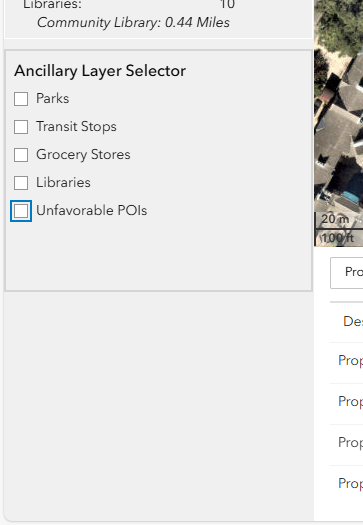

I'm trying to create a custom layer widget which would be open and look something like this:
I created the above example using the calcite component example provided in the resources folder and then put it in my > client > your-extensions > widgets folder.  I modified the widget.tsx code to reflect my target layers.  I just don't know where or with what code to add the layers URL/feature layer info that would correspond to each checkbox.

 Any advice or a different approach would be helpful. Thanks in advance.

There are a couple of ways to approach this:
  1. You may need to create a settings.tsx file and have named sources to setup for each layer.
  2. You have the option of hard coding them, but I usually prefer to avoid that, because if the experience is ever shifted to another domain, then if those services move, you have to update and republish the custom widget.  Using a settings screen in the dashboard editor allows you to reassign them more dynamically, and not be slaved to  a programing GIS developer's availability to make those changes.
    Note: I see you are using the more HTML version of Calcite, rather than the react calcite component versions.  I believe those can still work, but that also may play a role in the ultimate look of this one.
    Once you have a way to add all the layers you want to control.  (And in theory you could have a text box for the name of each one to capture and associate with each one you add so you can add layers easily too), you would then need a way based on the index of the check box buttons, to decide which layers you are hiding/making visible.
    Now once you know the index, and how it maps in code to the data source, then you may be able to toggle visibility I believe.   (I don't have a good example of doing the visibility toggle in code handy though)
