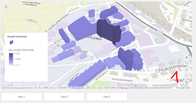

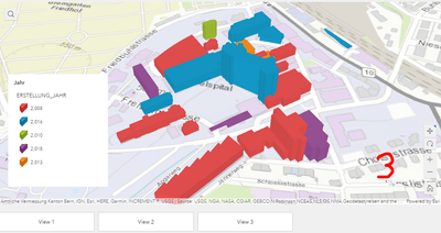

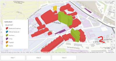

Hello,
I'm wondering if there is a simple way how to control multiple layers (on/off).
I'm trying to give the user an option to switch between different legends and colors using a button.
Something like this:
All I need is a button to turn certains layers on and off. But I don't see a way without the API. 🤔
