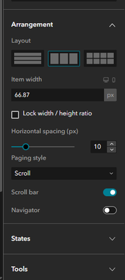

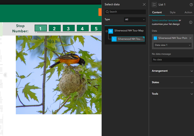

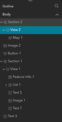

You're not too far off but we used a visual trick here since buttons couldn't do what we needed. The number "buttons" on the top right use the list widget with the same source data as the map. Our action is set at the map level to trigger for record selection changes.
Then our image widget uses dynamic attachments and our information at the bottom with audio is all using the Feature Info widget.
Hope this helps and let me know if you have any other questions for how we configured this 🙂
