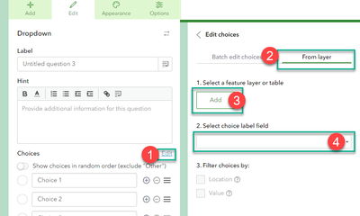

I am wondering have your tried dynamic choice list feature? This feature can pull the record from a selected feature service, and then put them into a dropdown question. I guess with this feature you could just select the plant directly in the survey widget without the needs of list widget.
To try this feature you can simply add a dropdown question to your survey -> click the Edit linked button beside Choices -> click the from layer tab -> add the feature service of plant name -> choose the field you want to use as the choice option.

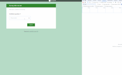

Sorry for the late response. The dynamic dropdown loads the first few thousands records initially (the number is based on the maximum query count). While you typing in the dropdown, the dynamic dropdown start to query the records with the specific content, so it will appear in the list after a few seconds.
