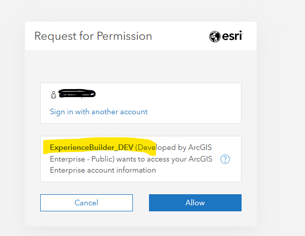

I  have configured Experience Builder Developer version 1.17 and while starting the node.js server on localhost:3001 it is asking for the location of portal and AppID/ClientID. I have three portals - one is ArcGIS Online, second is ArcGIS Enterprise v 11 and third is ArcGIS Enterprise v 10.9.1. I have created an application under new item on each portal and registered it to get the AppID/ClientID. Everything works fine when I launch the https://localhost:3001/ and use the portal and AppID from AGOL or ArcGIS Enterprise v 11, but when I use the portal and AppID for ArcGIS Enterprise v 10.9.1, it shows me the screen (Request for Permission)
where i see the correct application listed. When I click Allow, it gives me the following error
The specified URL cannot be found.

QaziIqbal1
You do not connect to multiple environments at the same time, but you can configure to one at a time. When you type npm start on command window, it opens the browser and there you can choose which environment to connect.
Like I mentioned I have Developer credentials set on three environments, two of them work fine (AGOL and ArcGIS Enterprise V 11), ArcGIS Enterprise V 10.9.1 is giving me this issue.
