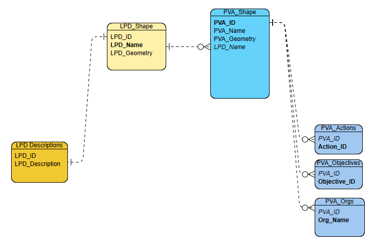

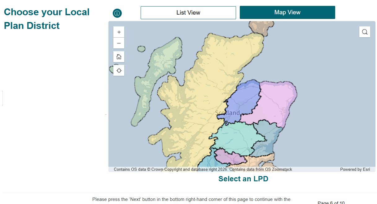

Using the data relations in Fig. 1, filters are applied to the LPD_Shape table using 1 of 2 selection (either selection in a map, or selection from a list (see Fig. 2). when switching between views (or more specifically) sidebars using the white button ("List View" in Fig. 2). It has 3 actions attached to the push button trigger - clear selection > clear filters > toggle sidebar (I tried swapping the order of selection and filters - to no effect, i also tried using the clear all filters and the selected data filters - no effect). switching between views clears the down stream selection (for LPD_Information) but not the filtering. when pressed

Fig. 1. Data relations:
Fig. 2 Page example:
