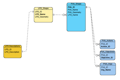

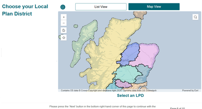

Using the data relations in Fig. 1,  filters are applied to the LPD_Shape table using 1 of 2 selection (either selection in a map, or selection from a list (see  Fig. 2). when switching between views (or more specifically) sidebars using the white button  ("List View" in Fig. 2). It has 3 actions attached to the push button trigger - clear selection >  clear filters >  toggle sidebar (I tried swapping the order of selection and filters - to no effect, i also tried using the clear all filters and the selected data filters - no effect). switching between views clears the down stream selection (for LPD_Information) but not the filtering. when pressed

If I select LPD1 on the list (and/or the map) , then look at the PVA selection page (a different page) it will show PVAs 1-4. If I then select LPD2 in the map WITHOUT manually unselecting LPD1 first in the list then No PVAs will show in the PVA selection page as if it is looking for PVA's where the LPD_name = LPD1 & LPD_Name = LPD2.

Fig. 1. Data relations:
Fig. 2 Page example:
