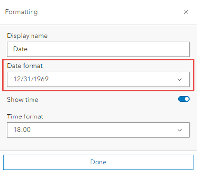

Hi, there are no plans for when this feature will be implemented. However, if you want to use a different date format, you can update the format in the Map Viewer, and the Experience Builder will inherit this format.

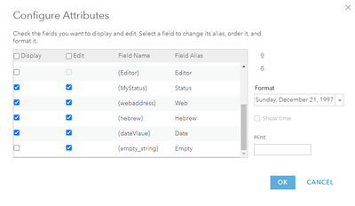

Hi, I tried changing the date format in Map viewer classic - configure popup - configure attributes, and the date format in the ExB map and text widgets change as well.
Are you using a table widget to display the data, it is a known bug that the table widget doesn't honor the date format configured in the map viewer.
