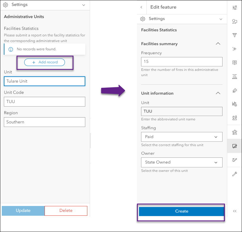

Hi, I'm seeking advice on how to carry values from the parent featureservice across to a related record table. In the example image below from this blog you can see what looks like Unit = TUU has been carried over from the parent and into the related table. I've used smart forms and calculated expressions a bit but aren't sure whether I try and leverage the relationships or if there is another way to define this via a calculated expression on the Unit field in the related table.
In my case, this Unit value would  then define the options available in the Staffing and Owner fields via contingent values. The Unit field is also be a domain.

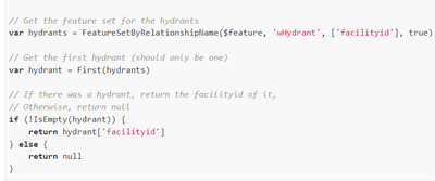

I've solved this via the common calculated expressions for field maps  post
what initially took some time was determining the relationship name to use in FeatureSetByRelationshipName. After publishing the parent featureclass, the related table and the relationship to Portal, I couldn't see anywhere where the relationship class is explicitly referenced or named.
In my case where I was applying an arcade expression against a field in the attribute table, the relationship name was actually the name of the parent polygon feature service. Hope this helps someone else
