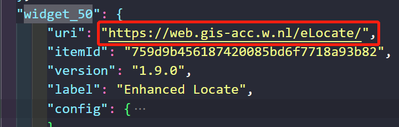

I guess your problem may be related to this custom widget. This widget is not included in your devEdition.

BolanChen
LucVanDijk
@BolanChen Thank you for pointing this out! This was indeed the problem. I had upgraded my installation of ExpBuilder Dev Edition from 1.10 to 1.14, but forgot to reinstall the eLocate widget. I recompiled and reinstalled the eLocate widget in ExB Dev Ed 1.14, imported my Web Experience from the Portal, removed the broken eLocate widget, added the new eLocate widget, reconfigured it and saved the edits. The save worked this time. Thank you again! Much appreciated 🙂
