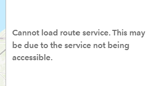

Cannot load route service. This may be due to the service not being accessible.

EB Community, I am converting one tool from Web App Builder to Experience Builder. I added the Directions widget and loaded our AGOL locator sources. For the Route Settings, our AGOL organization uses the Esri default, route service. In EB, the option shows up as route. After publishing, I make sure the use of the routing tool is allowed for public usage (outside of our AGOL org). When I preview (or open) the EB page, the subject text appears in the Directions portion of my experience page. Am I missing something? Thanks

Hi Dan, I was able to get that resolved with a colleague. I was referencing an inactive routing service from our portal.
