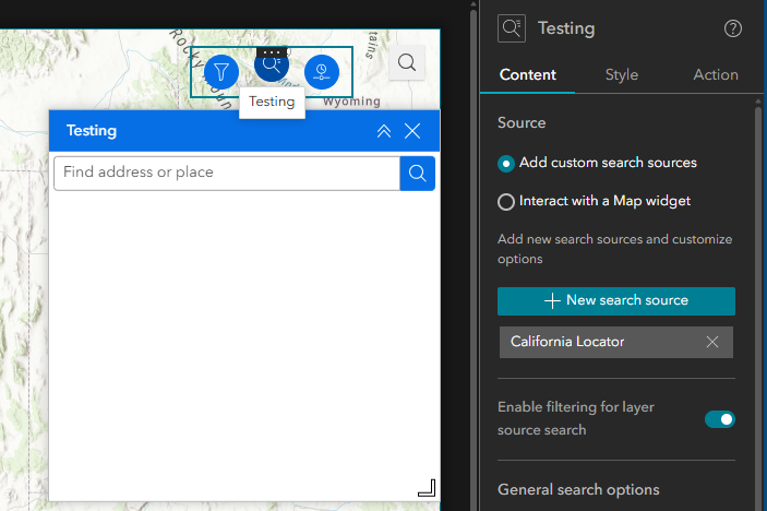

Hello!
I have a user who would like to change the text that displays when hovering over a widget. At the moment, I can change the hovering message if I rename the layer. Example changing 'Search' to 'Testing': MBocek_2-1769033763983.png
Is there a way to keep the name of the widget while changing only the hovering text? Ideally, something like what the 'tooltip' field does for the Text element.
JeffreyThompson2
MVP Frequent Contributor
You can build a fake Widget Controller using this method. https://community.esri.com/t5/experience-builder-tips-and-tricks/the-diy-widget-controller-part-ii-t... And the Button Widgets you will replace your Widget Controller with have a Tooltip value you can use to make the tooltips.
