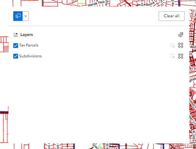

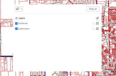

@ChristineTombleson1When you're using the live version, are you activating the tool? After selecting 'Rectangle' from the dropdown, you also need to activate the tool to start making a selection.
Not Active
Active
Not Active
Active
ChristineTombleson1
Thank you!!!!!!!!!!!!!!!!!!!  You solved my issue.  I knew it needed to be activated but we thought we were by selecting rectangle, etc.  Your image made it clear what the problem was!  Thank you so much, we have spent hours on this!!!!  You have made my day!!!
