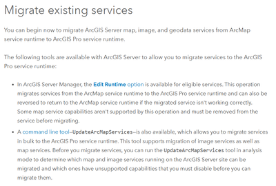

MKa
Are you saying that my feature service that I point to in my Experience Builder app has to be updated.  My admin says he ran the batch upgrade process on the Feature Service previously created in ArcMap to get it to ArcGIS Pro when he upgraded the Runtime.  We need to run the manual process?  The Feature layer does load, but when we apply a query to it we get the above errors.  We will try your fix and get back to you, but would like to know how the layer loads on the Experience builder map, but the query causes this problem to show up.
Right now, When I look at our feature layer in question it shows the supported query formats like below
Supported Query Formats: JSON, geoJSON, PBF
Doesn't this look right, or do we have to do the publish using ArcGis Pro and it should be good.

You needn't to run the manual process. Batch upgrades and manual upgrades yield the same results.
I think it is related to the above bug. Could you try to republish one service from ArcGIS Pro?
