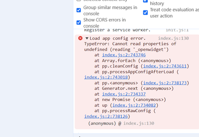

I had the same yesterday, luckily I made a change in a test version of the app and not our Production version. After saving the ExB app, i could only see white screen and the error in dev tools:
