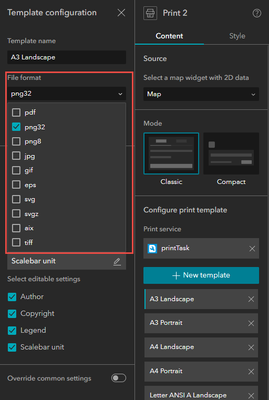

You can export a .PNG by adding the "Print Widget"  I have been unable to get it to allow you to export a PDF thus far; something I really need.
ShengdiZhang
Hi @GaryMorris2 ,
If your print service supports PDF format, you can add pdf in the print template configuration:
Shengdi
GaryMorris2
This is great; thank you!
amarcz_cc
Is there an option to Default to PDF? Instead my users have to toggle PDF from the default of PNG32
