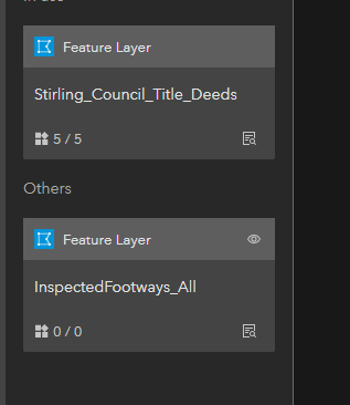

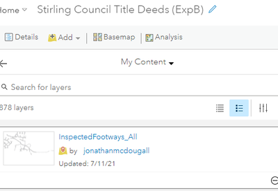

I've just added this;
Giving an updated ExpB of
In ExpB itself, once you've either refreshed the page or just opened it back up for editing;
For me, everything works as I would expect.
