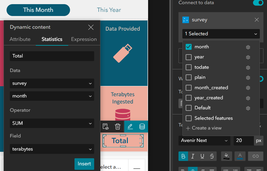

Trying to calculate statistics for dynamic content whereby the expression (which I named "Total") returns the sum of the "terabytes" field for all records in the past month. After publishing, and editing the field in the related feature layer table in AGOL, the total does not update. What am I missing?Screenshot 2024-06-11 154245.png

Hi @ElliottD , you can try open the auto refresh setting for the data. Then, once the data is updated in AGOL, the data in ExB will be updated accordingly.
