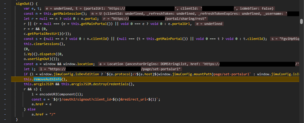

I stepped into the signOut code at runtime and discovered the following code. I stopped execution on this.removeAuthInfo().
From what I can tell, at  the end of this method Experience Builder will redirect the application to the portal signout page with a redirectUri that depends on jimuConfig properties
  • If `window.jimuConfig.isDevEdition == true` then redirectUri = currentPath + "page/set-portalUrl".
  • else if `window.jimuConfig.isInPortal == true` then redirectUri = currentHref
  • else the redirectUri = protocol + host + "/page/landing"

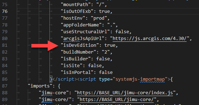

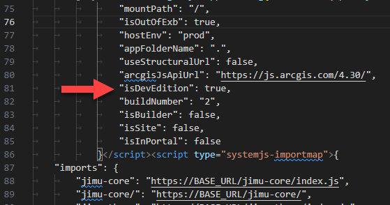

When I deploy the experience per esri documentation isDevEdition appears to be perpetually true. I think this is set in the generated index.html.
