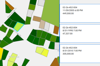

Boyang_Wang
Hi Josh,
Thank you for suggesting List widget. Is there an online tutorial showing how to set it up to show related record? What I want to achieve is clicking on a feature in the map to show the related record in the List widget. Should I setup the action in Map or List widget?
For the apps developed using Experience Builder Developer, can they be deployed in ArcGIS Online or Enterprise Portal?
Boyang

Boyang_Wang
Hi Josh,
I just tried it out using List widget. Although it is like redefining the relationship regardless of the feature service definition, it works for me. Thanks!
Boyang

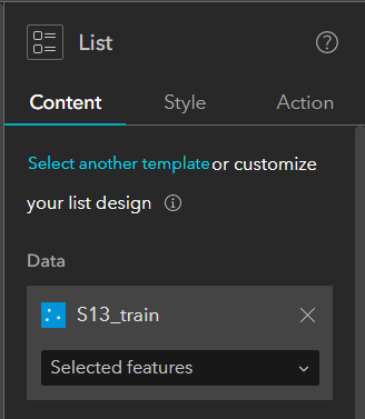

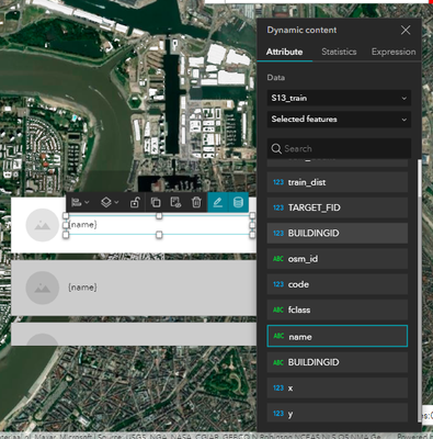

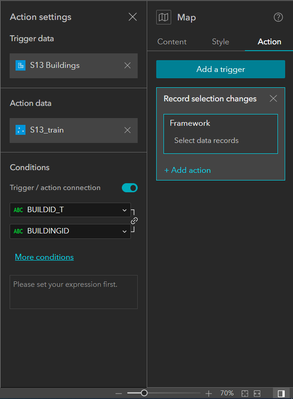

VictoriaJadot
Hi Josh,
I've tried to work with this method you explained. Let me show you the steps i did with the help of some screenshots.
First, I set up a trigger on my map as you did:
Next, I make a list and select 'selected features':
Next, i put the name of the selected features as dynamic content:
Now the problem that i am facing is the following: the list doesn't update when clicking on a building, so the trigger is not working. I keep getting the 'No data' sign on my application:
Important to mention maybe: The S13 buildings layer is a 3D scene layer and the S13_train layer is a 2D feature layer. These two layers are also not in the same web scene, i don't know if this is a problem or not?
Do you know how to make the trigger work in this case? Thank you in advance and best regards,
Mauk
SolanaFoo2
I'm having the same issue as Victoria.  Please mark this as unresolved again.  There may be a new bug perhaps?  I'm working with a feature class and related table feature service.  No 3D involved.
Also, it works for me between the map and a table widget where if I select a polygon in the map, the polygon record is selected in the table.  But I had set up the action on the related table and that selection is NOT working in the table widget.
