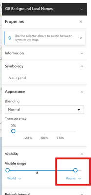

SarahNoakes1
By default, some of the Living Atlas basemaps have a threshold:
Dragging the slider to "Room" (or 1:0) has fixed the duplicate basemap issue for me 🙂
