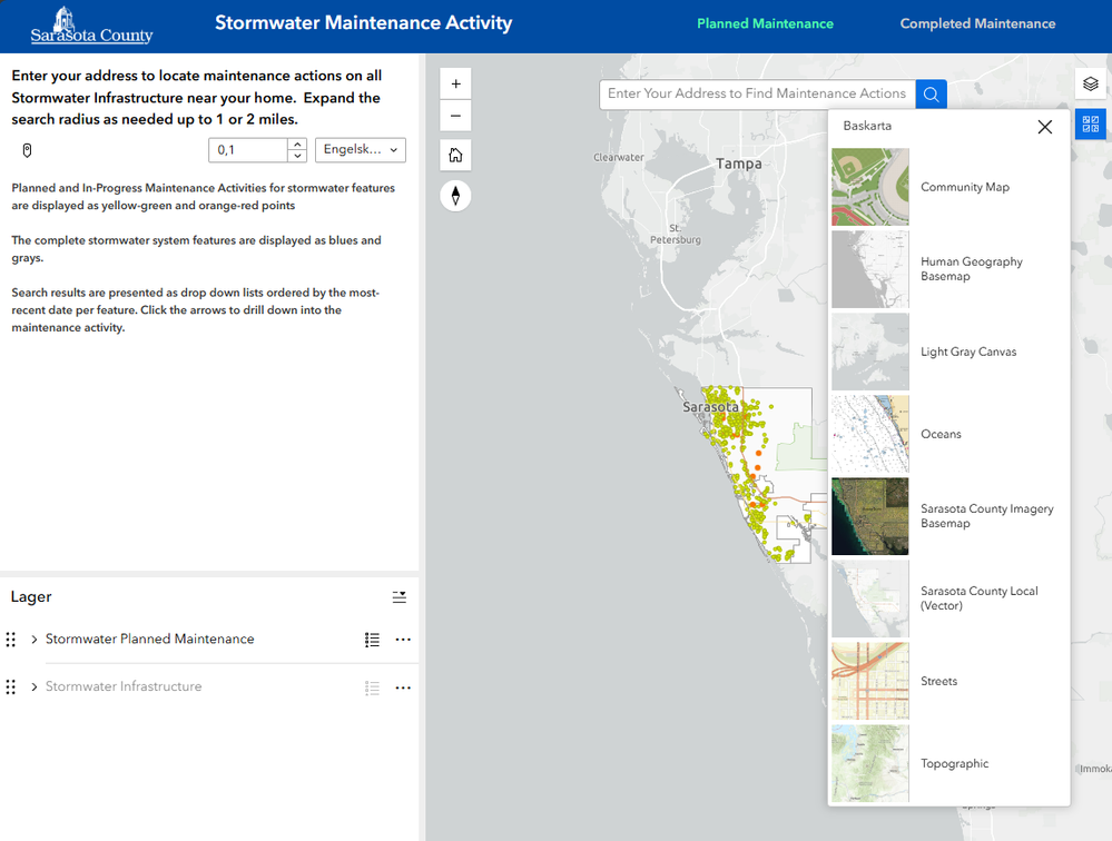

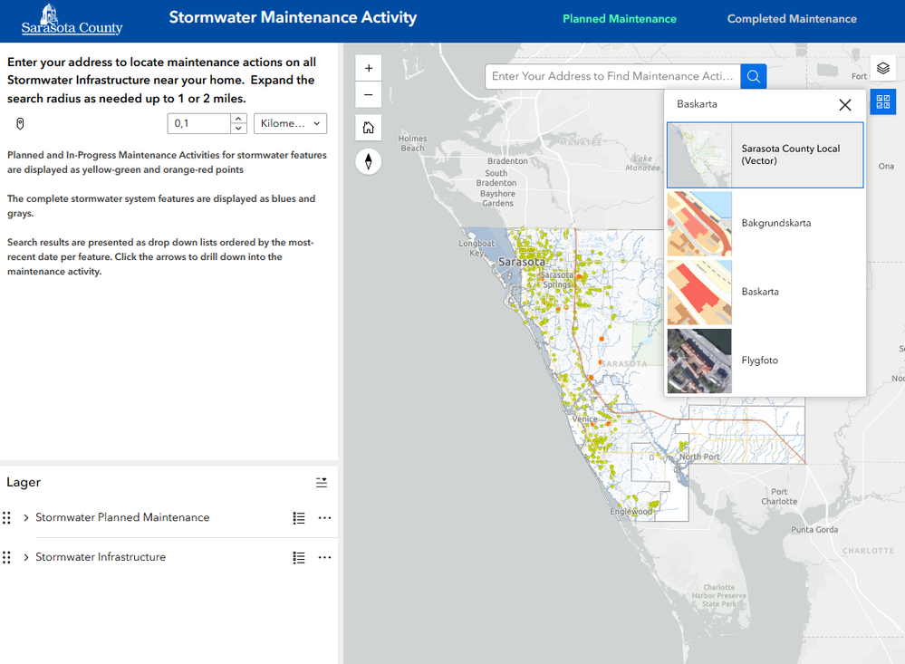

If I go to https://experience.arcgis.com/experience/36f63bf761e4483b9e89120efe8ed860 I get this
That's my custom basemaps in my ArcGIS Online organisation. They are completly irrelevant in that experince, I suppose that's not by design? I should add that I was signed in to my AGOL account in that browser.
If I use the same link in another browser where I'm not signed in I get this:
Without the duplicate. However, if I change the basemap, close and open the basemap gallery then the duplicate shows up.

Thanks for the feedback here @MattiasEkström  - No, you seeing your custom basemap gallery is not by design as far as I know, I've never seen that before..... your second screen shot is what everyone should see.

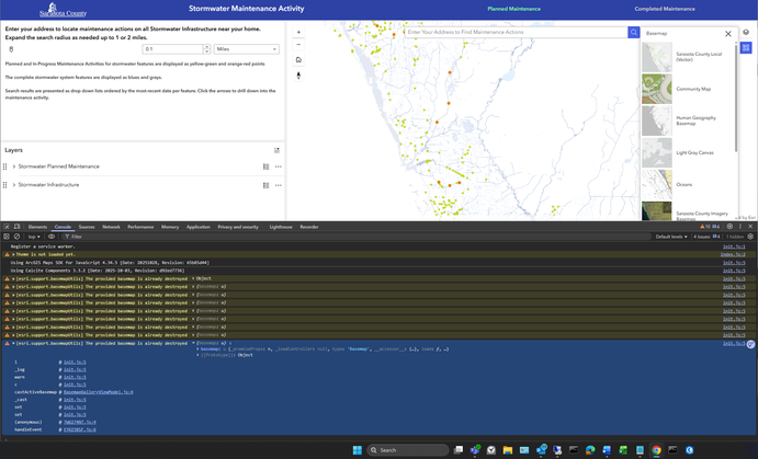

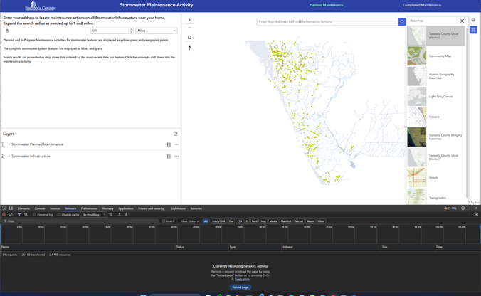

I now see this in a Chrome browser if I open - close - open the basemap tool:
That is to say, no basemap tiles pull in from the top 'duplicate' local custom basemap (or any network traffic at all). when using Chrome or Edge.
The console shows the reason why:
The basemap has already been destroyed.
Interesting.  Again, thanks for looking at this.

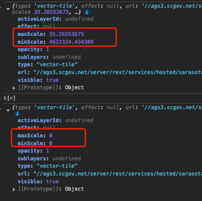

Based on our developers' investigation, these two have the same URL, but one has maxScale & minScale, the other's values are 0 & 0:
They have different scales, thus they are listed separately, as different basemaps. Not sure why though...

Hi @TonghuiMing  - would it be possible for you to share more of what you are seeing in the console log, for which app or service, and where you are locating it this descrpancy in the console?
The only vector-tile service I have listed from my host site that could possibly match the url stub I see in your screen shot is this:
https://ags3.scgov.net/server/rest/services/Hosted/SarasotaCountyBase/VectorTileServer
And this service does not show 0,0 for a minScale, maxScale
