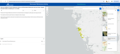

Hello - The basemap tool in the Experience Builder map tools now shows custom basemaps in the basemap gallery twice when a custom basemap is used as the webmaps basemap.
When a custom basemap is not used as the webmap basemap, for example the Streets or Topo, this is not an issue.
To see what I mean you will see the "Sarasota County Local (Vector)" basemap twice:
https://experience.arcgis.com/experience/36f63bf761e4483b9e89120efe8ed860
The webmaps in this app use a custom localize basemap with some vector tile layers.  When the user opens the basemap tool, this custom local basemap appears twice.

Weird...this is what I see, and I do not find the duplicate ones

That is strange @TonghuiMing - your screen shot does not show the custom vector tile layers making up the basemap - it is only showing the light gray base.  The screenshot from @Ke_Xu is showing what I have been seeing - and am seeing this morning - 2 basemaps that are only being duplicated in the basemap selector tool.

Based on our developers' investigation, these two have the same URL, but one has maxScale & minScale, the other's values are 0 & 0:
They have different scales, thus they are listed separately, as different basemaps. Not sure why though...
