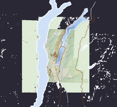

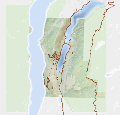

I have a basemap in an ArcGIS Online map.  The map renders fin in ArcGIS Online:
However, when I add this map to an experience builder project, the map renders with black around the edges:
Has anyone seen this before?

Any bit of empty canvas will render as "transparent" in the map, unless of course you define a background color in your map settings. Because of this, you'll see the color of whatever is "under" the map. The map widget can have its own background color settings, but if you don't have that set, you'll see whatever you Experience page's color is.
Try explicitly setting a background color setting in your map and see if that fixes it.

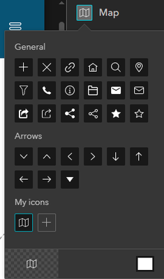

The trick is though...where do you set the map background in Experience Builder?
cjms
It's the map icon next the title "Map" on the right side.
