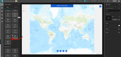

1 - In ArcGIS Enterprise, create a new ExB application, and add the "Add data" widget:

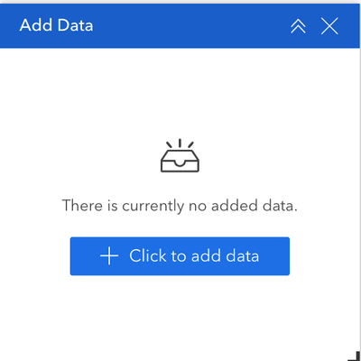

2 - Using the widget in the preview:

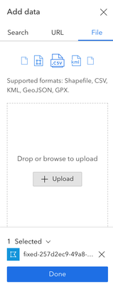

3 - Add a GeoJSON layer (it happens for PNG URL images as well):

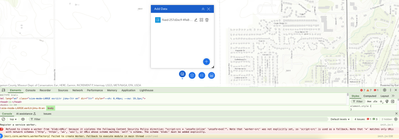

4 - The layer is added but no data is displayed. See the error in the console:
