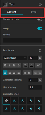

JenniferAcunto
The way I learned it is Content vs Style. If you make Content changes (anything found under the Content tab) it will change across all screen sizes. Style changes (anything found under the Style tab) will only change for the specific screen size you are working on.
