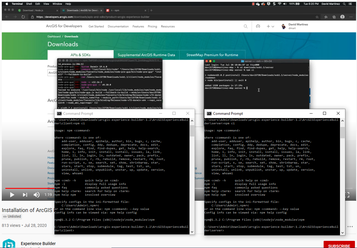

The requirements included your own installation of the ExB Developer Edition ~for which there is a handy video that purports to 'walk the viewer through the installation steps.'  There's a bit of a gap in the instructions 37 seconds in.

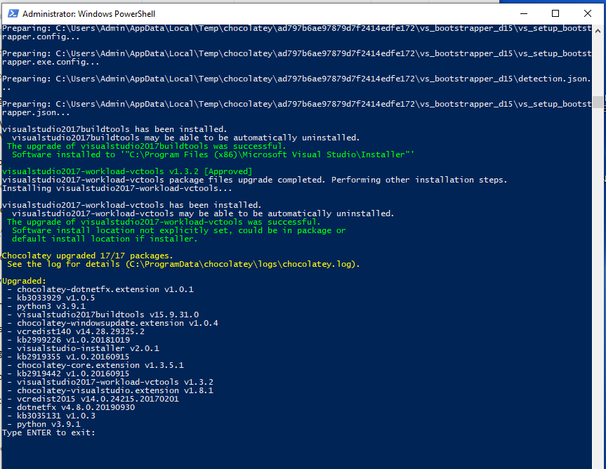

DavidMurray1_1-1610673370620.png   But I was able to download & install nodejs, and the various "necessary tools" for its use, including "Chocolatey."
I have opened cmd prompts to "clean install" the client and server, but typing npm ci does nothing.
 So, I'm stuck on Step #8 of installing the Developer Edition.

It was, as I'd supposed, a newbie error.  And it was your question that led me to the solution.
The failing cmd window printed:
Need to pay attentionNeed to pay attention
...clearly showing that it was trying to find nodejs in C:\Program Files (x86)\ and version 1.3.2
When I'd downloaded the newest version into C:\Program Files\
So I renamed the original nodejs folder to nodejs_old, and reinstalled the nodejs to the x86 folder.
Step #8 now works without a hitch.
