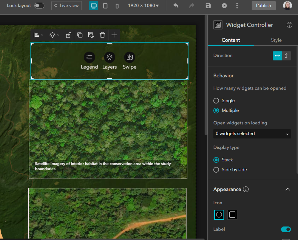

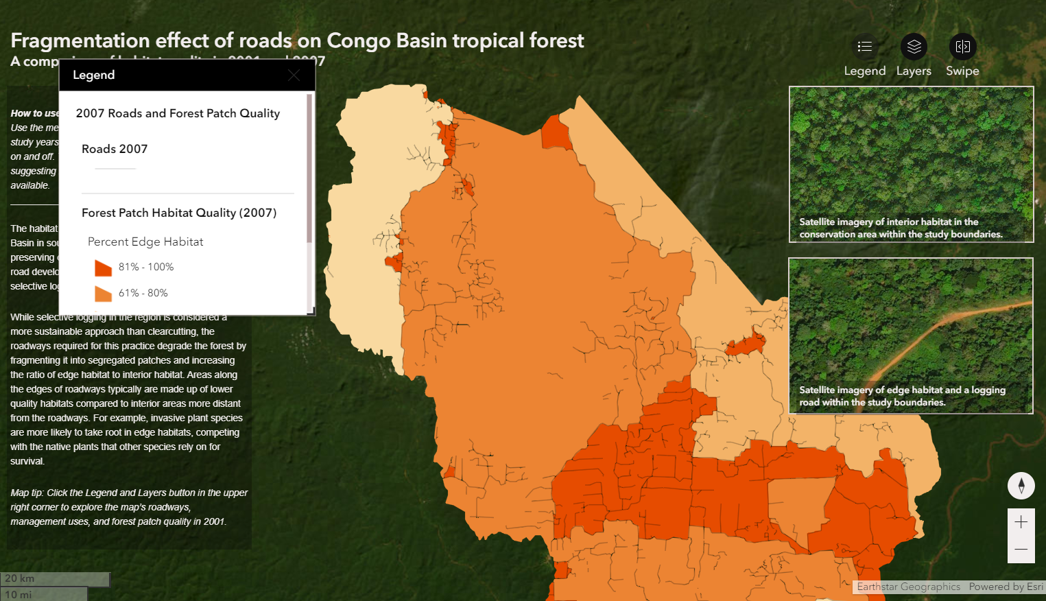

I am using the Widget Controller widget containing buttons for the Legend, Layer, and Swipe widgets. The windows for these three widgets open in an odd location on the page far from the widget controller, even though the Widget Controller is nested within a Fixed Panel. See screenshot below for example of the pop-up position of the legend when I select the Legend button in the Widget Controller
Is there any fix for this or am I stuck with this nonsensical arrangement of my widgets?

LydiaKateYoder
Hmm, the option to change the widget panel arrangement is not available in my Widget Controller settings (see below).
Shen_Zhang
Widget panel arrangement setting is exclusive in Single behavior. For Multiple behavior, it does not have a fixed panel arrangement - both Stack and Side by Side display widget panels like a float panel. So you can consider them same as a float panel in Single behavior.
Shen Zhang
LydiaKateYoder
Ahhh ok, that makes sense. Thank you! I switched to Single behavior, and I'm now able to use a fixed panel arrangement.
