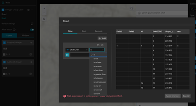

Hi @JonathanHall3 -You don't need to split a large dataset into 20 individual data. You can create multiple data views using a single data as the data source. For each page, you can create a data view from the original data so that it can display results for a specific topic area in the survey.
I believe this should work but the "big table" should include columns or fields that clearly label the survey question or topic area, so you can use expression builder to extract relevant subsets for each visualization.
